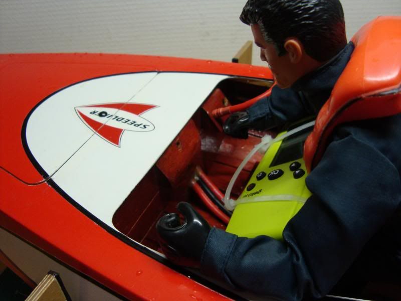

Here's an update.
I took your advice and I reinforced the bow handle:
Of course after the picture I pressed it fully down :)
