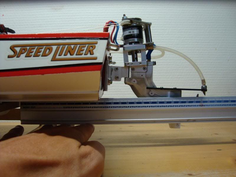

Dirk Jan. You really did a great job in trimming her. There is actually no tendency to roll around her longitudinal axis.
Could you please make a photo from the side that shows hight and tilt of the outboarder?
And it is still the stock brushless motor, with the aluminium propeller and a 3S accu, right?

Ulmo, It runs with the stock setup, stock prop and 3S lipo. After I placed the lipo a little left from the longitudinal center, it doesn't roll at all anymore.
The outboard is tilted down a couple degrees and the prop is almost fully submerged, I guess 90%. I will make a picture tomorrow to show it.

Here's the picture you asked for. The prop sits a little higher than I said yesterday. About 80% submerged as you can see from the picture.
Thanks for the pic. So you have your prop deeper than I have mine. VO-9 runs better this way.
I'm meanwhile convinced that the overhangs and the 400 grams less weight really make the difference. How long can sustain this speed? Or asked differently, did you ever try to go about 5 minutes which will approx. the duration of our closed course race?
